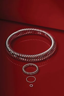

Coils can be made in a variety of sizes, such as these from Bal Seal Engineering Inc.

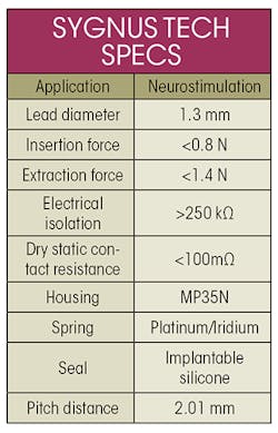

The table lists the functional and physical attributes of a Sygnus multi-contact connector used for neurostimulation. The connector lets OEMs save space while increasing the functionality.
