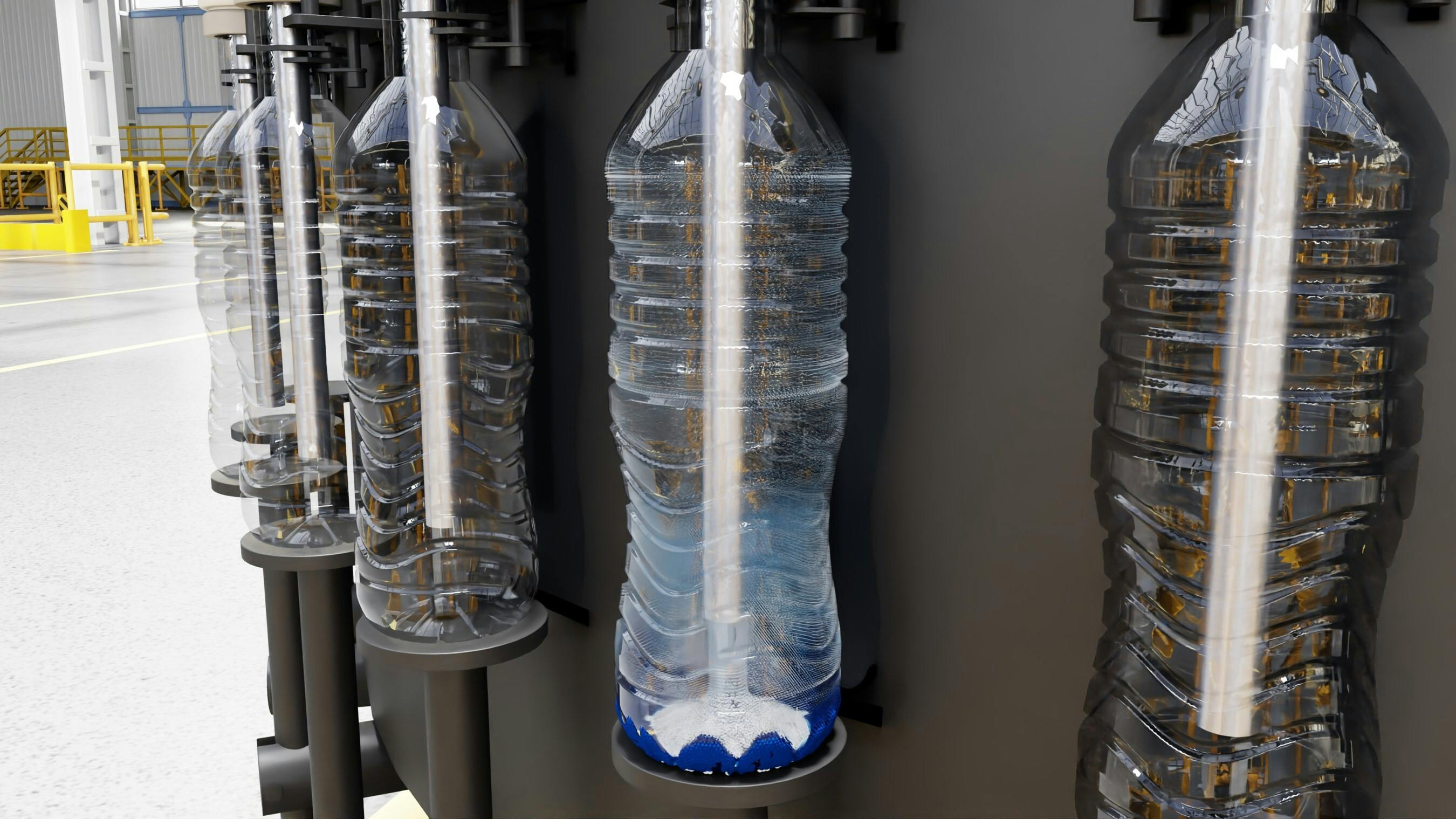

The collaborative simulation-driven framework aims to improve dynamic manufacturing processes with significantly reduced runtimes, according to the press release. The framework was first implemented by Krones AG, manufacturer specializing in integrated packaging and bottling lines. Krones created a digital model of their assembly line that accounted for manufacturing variables such as bottle geometry, liquid viscosity and fill level. This virtual assembly line enabled the assessment of production scenarios in near real time.
The main technical challenge addressed is the reduction of CFD simulation time from several hours to less than 5 min., which was achieved by using a GPU-accelerated cloud native simulation solver developed by Synopsys. By leveraging parallel processing on GPUs and cloud computing resources, the framework supports rapid scenario analysis and continuous process improvements.
