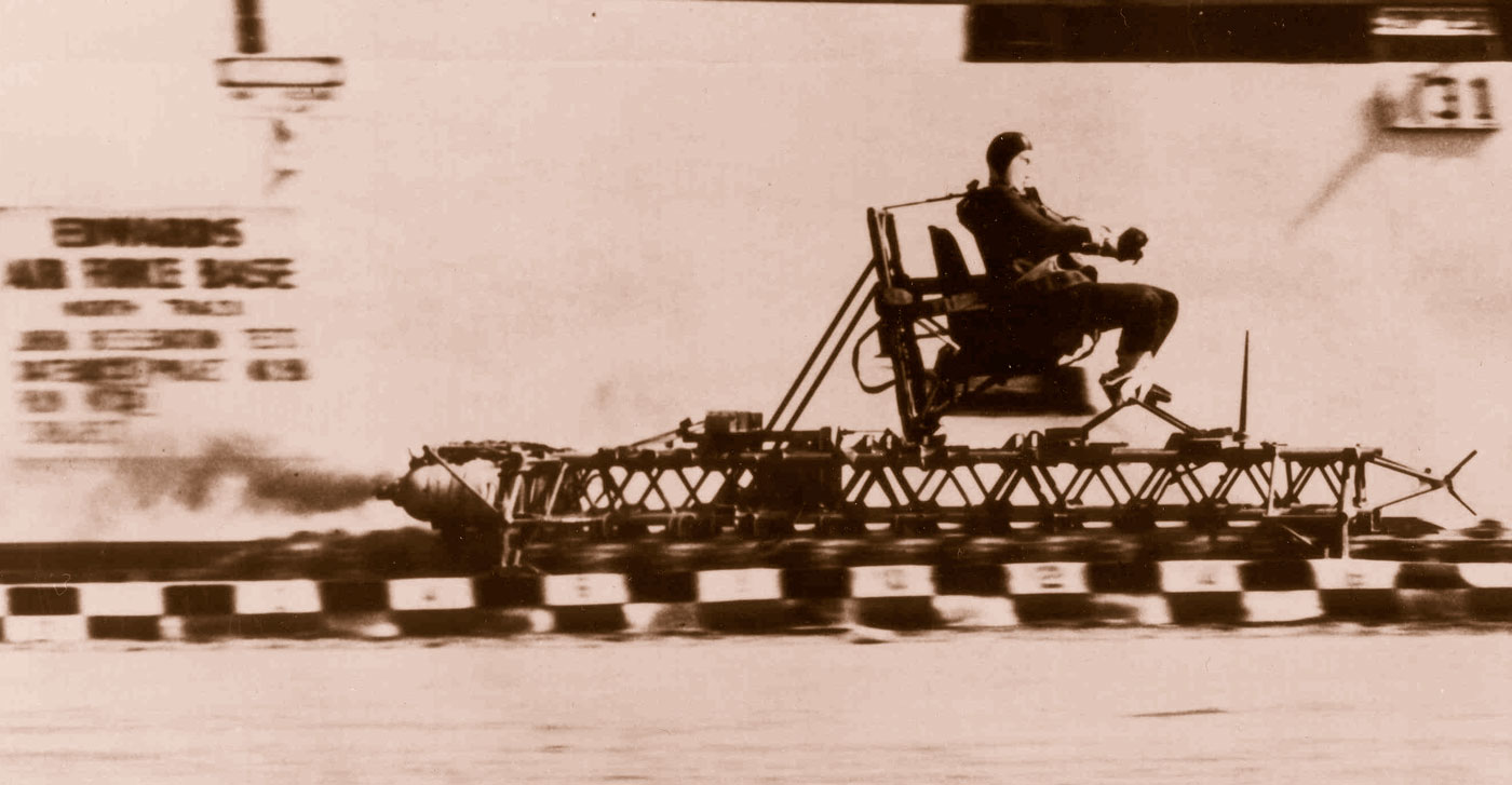

Stapp worked on the Deceleration Project in 1947 to develop equipment and instrumentation that could be applied to simulations for pilot training. They would also use the data to develop better harnesses and seats to help mitigate physical damage to the human body. At the time, scientists concluded that the human body could only withstand 18 Gs worth of force, but Stapp wasn’t sure their findings were correct. There was only one way to find out: use a rocket sled.
The first attempt at gathering data on g-force using a rocket sled ended in failure, in that the sled flew off the track and exploded. Instrumentation at the time was still being developed, and crash-test dummies were archaic at best, so John took it upon himself to become Lord of the Gs. He designed his own rocket sled and replaced the dummy with himself.
In 1953, Stapp partnered with the Northrop Corporation to develop the Sonic Wind Rocket Sled 1, which had a primitive modular system on the back that allowed the crew to add or remove a set number of rocket engines. The braking system on the Holloman test track consisted of using a scoop mounted underneath the sled to dig into a series of water dams at the end of the track. Six rockets were used on his first run, which propelled him at a speed of 421 mph using 27,000 lb. of thrust. When it stopped, his body underwent 22 Gs of force, significantly more than what scientists thought possible.
The culmination of the Deceleration Project saw Stapp’s sled outfitted with nine solid-fuel rockets, which powered the Sonic Wind to 632 mph in just five seconds and ended in much less time. The g-forces he underwent were astounding, causing him to weigh 6,800 lb at the moment of his deceleration. It was his last ride, and it netted him a world record of being the fastest person on land, which still stands today.
