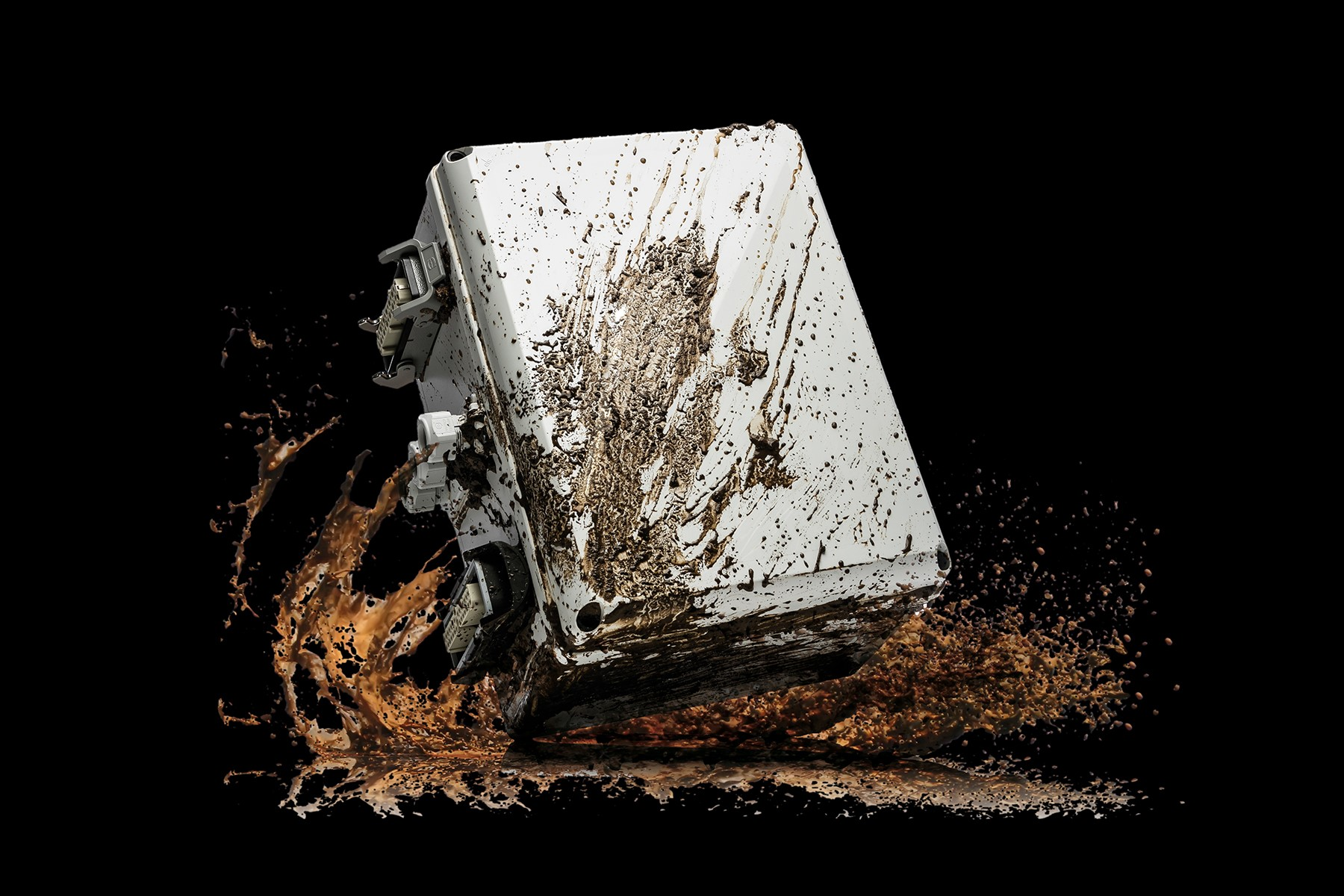

Making sure you have a well-sealed and drain protected enclosure might be perfect for one application while offering insulation protection could be ideal for another application. With polycarbonate material use, Altech Corp has been able to include protection ratings of IP 67 along with standardized approvals for UL and CSA. For applications where high humidity and extreme temperature changes could cause internal condensation, they offer a patented air ventilation element. For this system (see Figure 1), hot air is quickly transported out of the enclosure through an air exchange that is designed to allow the interior air to mix constantly with the environmental air to prevent condensation from forming inside the enclosure. Advantages of this include 100 percent pressure compensation, foreign object protection, and maintenance-free operation.

Polycarbonate enclosures offer other advantages in addition to basic ruggedness and flexibility mentioned above (see Figure 2). The enclosures also meet various relevant standards, including UL94 (Flammability of Plastic Materials, NEMA IP66/67 (particle and water ingress), VDE 0471 (fire hazard), and IK07 (impact). Particularly for the agricultural environment, polycarbonate enclosures are able to tolerate very high concentrations of ammonia, meeting the stiff certification requirements of the German Agricultural Society (Deutsche Landwirtschafts-Gesellschaft, or DLG). They can withstand an ammonia concentration of 750 ppm (parts per million) at 70 degrees C and 70 percent humidity over 1,500 hours of continuous testing.
