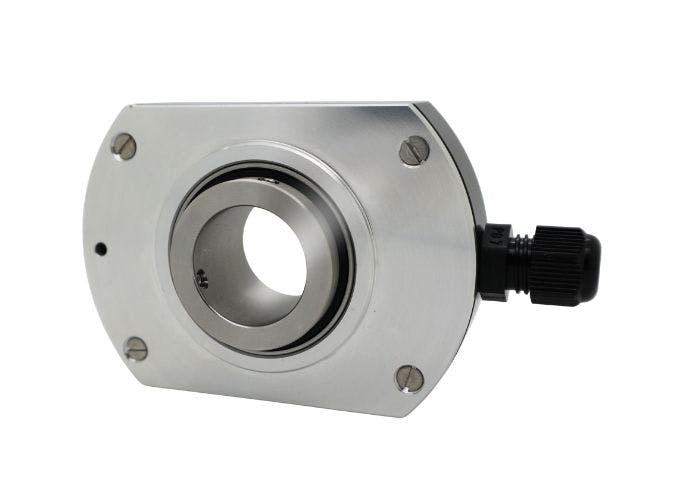

The new IH810 Series is a low-profile incremental hollow shaft encoder designed to provide precise motion feedback in motion control applications with limited space that require continuous operation. This encoder features a low axial profile, flange mounting, and a hollow shaft design for easy installation.
St. Catharines, Ontario, Canada, September 1, 2026 — Industrial Encoder Corporation, a proud member of Global Encoder Systems, introduces the new IH810 Series, a low-profile incremental hollow shaft encoder engineered for reliable motion feedback, space-constrained installations, and seamless integration into compact machinery, motors, and drive systems.
Designed for OEMs, machine builders, and system integrators, the IH810 Series delivers reliable incremental feedback for motion control and speed monitoring applications in space-constrained machine designs.
The IH810 Series features a compact Ø81 mm housing, hollow shaft bore diameters ranging from 15 mm to 30 mm (5/8” to 1”), and resolutions up to 5,000 PPR. It is available with Push-Pull (HTL) and RS422 (TTL) outputs, and supports multiple supply voltage options, including 5 VDC, 4.75-30 VDC, and 8-30 VDC.
The IH810 Series also features galvanic isolation to support reliable signal transmission in industrial environments.
The IH810 Series is particularly well-suited for applications with limited axial space behind the shaft, compact machine architecture, tight mechanical clearances, or direct shaft mounting requirements.
