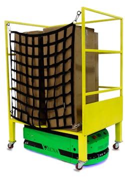

2. The RL350 robotic lifter from Verna Robotics rises under a cart and lifts 350 kg off the ground. It then delivers the contents to the desired location, dropping down and leaving the cart.
 Sponsored Assets:
Vecna Robotics has lightweight and heavy-duty robots, too. Its RL350 robotic lifter can hoist 350 kg or more than 770 lbs (Fig. 2). It can also adjust the payload height with other pieces of material-handling equipment, like conveyor belts. It can be used in applications such as fulfillment operations or lineside supply. The robot has a top speed of 2 m/s, and can run for eight hours before seeking out a charging station. It is ANSI/ITSDF B56.5 compliant and ISO Class D ready. It uses LIDAR and ultrasonic sensors like many of the other robots in this class.
