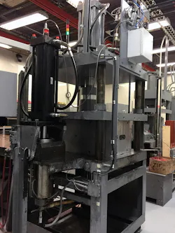

Black cylinder (upper left) compresses the hot wax. The cylinder (top center) clamps the mold closed against the injection nozzle on the stationary platen.

At the beginning of the process, a wax billet is loaded into the extruder cylinder with the temperature maintained by heater bands on the exterior. The extruder cylinder then forces warm wax through a heated hose to fill the mold, which is held closed by the clamp cylinder. The motion controller uses setpoints entered from a database for injection velocity and pressure to ensure a consistent fill.

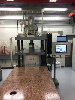

All injection functions are coordinated using a Red Lion touchscreen, the primary operator interface. The HMI also interfaces with an Allen-Bradley PLC, which controls power unit sequencing and safety mechanisms.
After the injection cycle is complete, the RMC75E creates a slight negative pressure in the wax line as the clamping cylinder retracts. This ensures no residual wax squirts out as clamp pressure is removed. All pressure values are displayed on the HMI.
The operation of the press is controlled and monitored on a Red Lion control panel. All injection functions are coordinated using the touchscreen, the primary operator interface.
