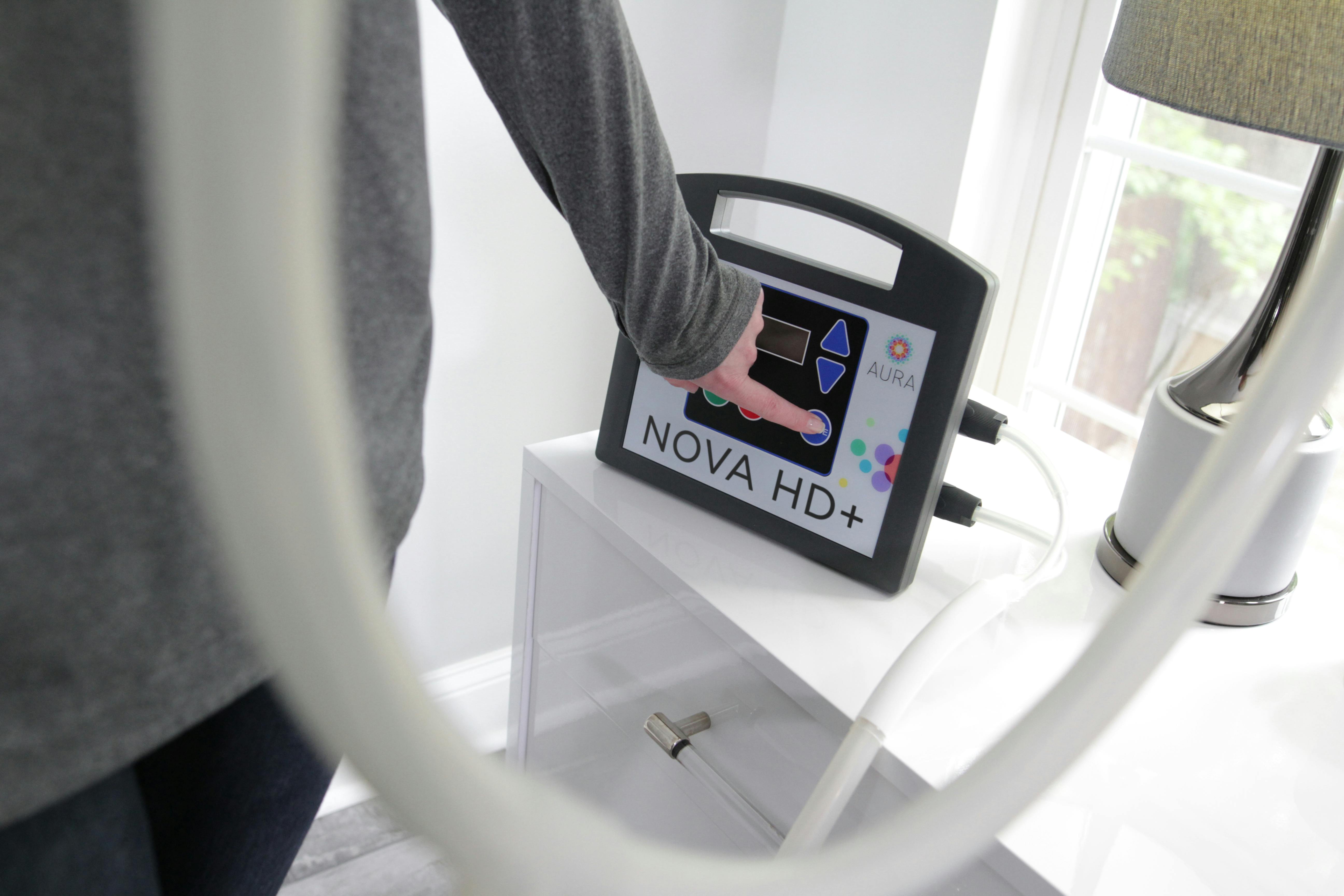

Paulley says she prioritized simplicity and ease of use above complex functionality. “I wanted as [few] buttons as possible, so it is start, stop, up, down…super-simple, so that anybody in their home could quickly start using it.”

The magnetic field is produced via an easily connectable attachment, designed to adapt for various bodyparts. Safety mechanisms ensure the device only energizes when the attachment is securely connected, using coil sensing and firmware checks.
Mechanical, electrical and software engineering teams worked in tandem to simplify the user interface while extending reliability and durability, Paulley says. For example, the original continuous “smooth” nob for power control was replaced with an incremental control faceplate—providing user feedback, reducing wear on internal components and ensuring precise reporting for clinical trial consistency.
“We had to sit down with different engineers and say, ‘how can we control the strength without the knob?’ It was a big decision...they did not agree at first,” Paulley recalls.
