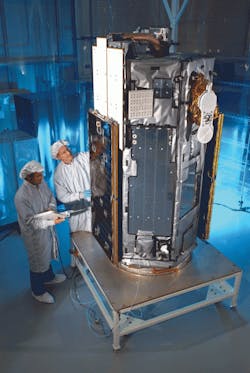

OCO-2 is built on a LEOStar-2 platform from Orbital Sciences Corp., Dulles, Va. LEOStar-2 was originally designed 10 years ago to be launched from Pegasus XL, an air-launched, winged spacecraft, but it is now routinely sent aloft on Taurus, Minotaur, and Delta rockets as well. It can be used for small-to-medium payloads and hardware weighing up to 1,100 lb. OCO-2 weighs about 990 lb. The platform has successfully served as the basic structure for several satellites, including the NuStar satellite currently taking X-ray images of the stars and the Galex satellite that took UV images of roughly 1 million galaxies.
LEOStar comes with avionics capable of delivering 2 kW of average power. The version housing the OCO-2 will carry a pair of triple-junction GaAs solar panels 10-ft long that generate 900 W when deployed and in sunlight. NASA estimates the craft will consume 521 W on average when operational. The panels charge a 35-A-hr nickel-hydrogen battery for backup power when the satellite is shaded.

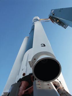

The OCO-2 will be carried into orbit by a Delta II outfitted with three graphite-epoxy motors that double the total thrust of the rocket to 500,000 lbf.
