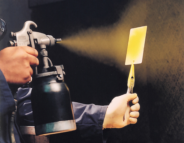

Spray testing of each lot is one of the necessary tests for medical grade coatings.

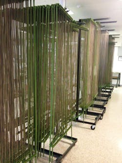

The number of coated guidewires used by medical practitioners, for cardiac, oncological, and other procedures is staggering. For each procedure, the low-friction coating on the surface of the wire provides the predictable “touch” so necessary to the operator. (This photo is courtesy of SSG.)
