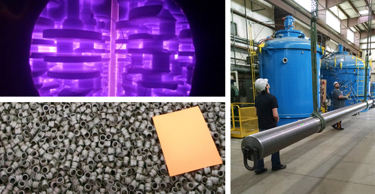

Plasma nitriding is done in a vacuum chamber which serves as the anode with the part to be nitrided, a crankshaft, serving as the cathode. Nitrogen ions bombard the part and form active nitrogen that reacts with surface and diffuses nitrogen into the steel. The plasma-glow discharge surrounds the load and it can be seen through the port window.

Plasma nitriding can be used for hardening long parts, such as this steel shaft, because it delivers a uniform diffusion of nitrogen along the entire part.

The most efficient and well-known methods of these treatments are plasma and gas nitriding or nitrocarburizing. If all-over treatment of component is required, gas methods should be used since the gas gets to all surfaces of the parts. If only partial hardening is needed, plasma methods are preferred because technicians can protect selected surfaces such as threads or thin sections to prevent them from becoming brittle. This is easily done by mechanical masking which eliminates plasma contact on surfaces.
But stainless steel components are usually better treated using a plasma process because it is effective at activating the surface. During plasma treatments, ions bombard the treated stainless steel and sputter off native chromium. This makes it easier for the surface of the steel to absorb and diffuse nitrogen. Gas methods, on the other hand, require activating agents such corrosive acids be added to the nitrogen-rich gas. The acids remove chromium oxides by chemical reaction on the surface.
Low-density sintered automotive products, such as hub synchronizers, slides for pumps, turbocharger components, and armatures, as well as those used in other industries, are limited to plasma-based treatments. That is because gas nitriding uses nitrogen-rich ammonia, a gas that can penetrate throughout a part’s entire volume. This causes internal nitriding and brittleness.
