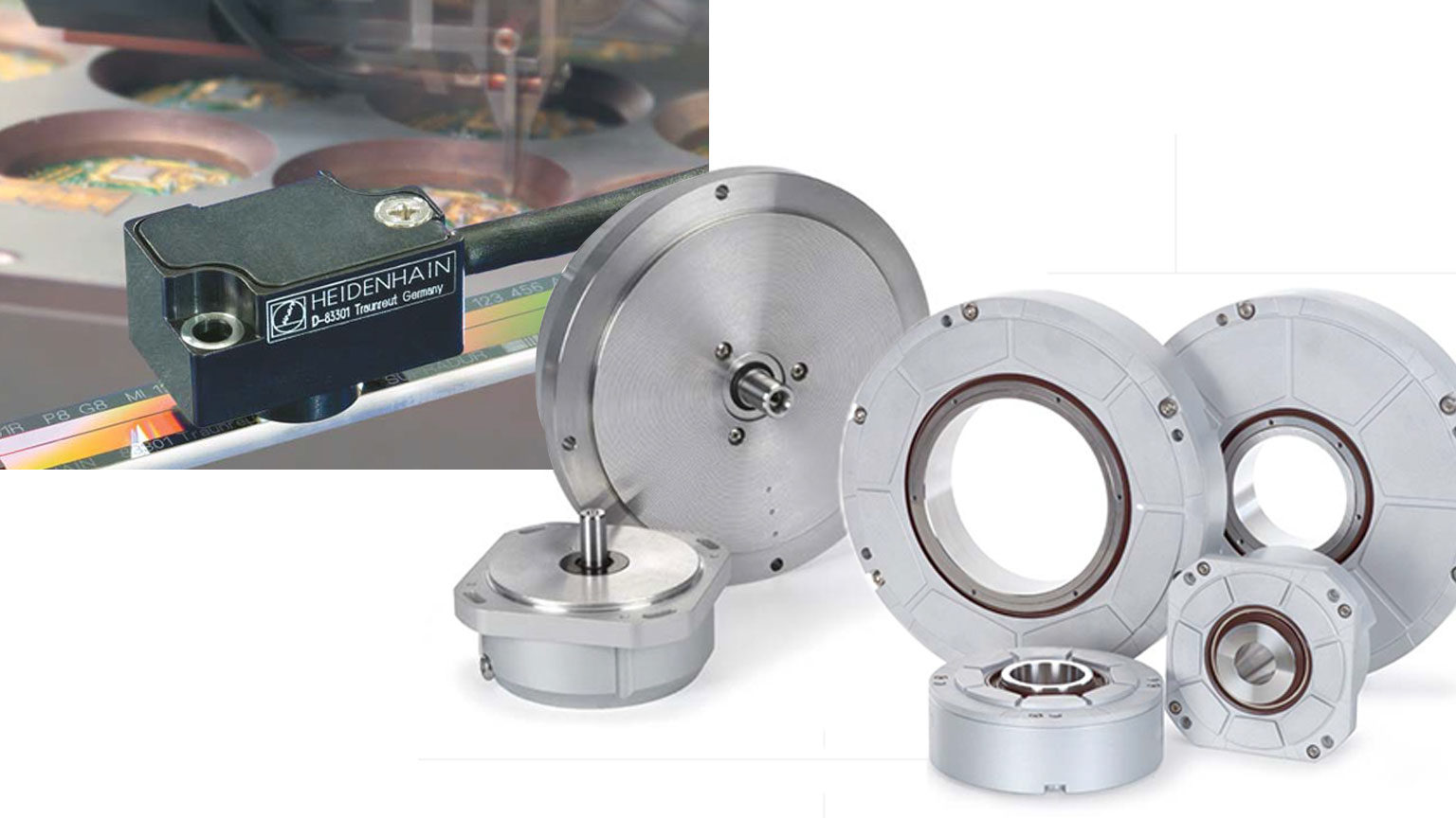

Linear Encoders
These measure straight-line motion. Sensor heads that attach to the moving piece of machinery run along guideways. Those sensors are linked to a scale inside of the encoder that sends digital or analog signals to the control system.
Rotary encoders measure rotational movement. They typically surround a rotating shaft, sensing and communicating changes in its movement. While they are accurate, rotary encoders are often used when speed management is the biggest concern. Traditionally, rotary encoders are classified as having accuracy above ± 10" (arcseconds). Rotary encoders are also available equipped with important functional safety capabilities.
When deciding on a rotary encoder for pairing with a motor, an engineer must consider the five key encoder properties that have the largest influence on motor performance: positioning accuracy, speed stability, audible noise, power loss and bandwidth. Read more about what to look for here
Angle Encoders
Similar to their rotary counterpart, angle encoders measure rotation. These, however, are most often used in applications when precise measurement is required. HEIDENHAIN offers angle encoders with accuracy down to ± .04″ (arcseconds) and resolutions up to 29 bits.
