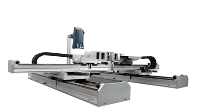

The application of MPC to a single-axis actuator is straightforward, and deviation from the exact commanded profile is unimportant for point-to-point motion. However, when one servo axis is mechanically linked to another, their motion profiles affect each other. A dual-motor ballscrew actuator is one such configuration.
This dual-motor configuration can be advantageous in larger applications for which the torque required to accelerate the motor’s rotor is significant and a single, bigger motor would be incapable of the torque and acceleration required. From a tuning point of view, the critical factor is that two relatively large servomotors are positioning a heavy load, and operating at nearly full rated torque and speed. If the motors become unsynchronized, their torques will be wasted on essentially fighting one another for position. However, if the gains of both servos are equal, then Model Predictive Control delays are also equal and the motors remain in sync with each other.
The first step in tuning an application like this is to physically remove one of the motors and tune the system as usual with just one motor. One servomotor is enough for stable axis control, but not enough torque to run the required profile. In this case, the manufacturer’s auto-tuning sequence is used, which sets an inertia parameter and enables the Model Predictive Control feature. Note: The system gain found with one motor must ultimately be shared equally by both motors. The inertia parameter makes this step easy because it acts as a scale factor to the servo loop gains, and so it is set to half of the original tuning result in each amplifier. The rest of the tuning result can then be copied from axis one to axis two. The final adjustment is to remove the integration component from axis two — assigning the second motor the role of “acceleration assist,” and leaving the small integration corrections to motor one alone.
