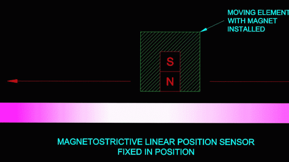

Magnetostrictive linear-position sensors measure the absolute position of a magnet, wherever it is, along the length of the sensors body (Fig. 2). The magnet is stuck onto the thing you want to keep track of.
2. Magnetostrictive linear-position sensors measure the absolute position of a magnet that lies anywhere along its length.

Proper operation has only three requirements: the sensor body must be installed parallel to the axis of movement, the magnet must be affixed to the moving element of the system, and the magnet must stay within the detectable range of the sensor at all times. Truth be told, they can often tolerate some minor misalignment of the magnet.
