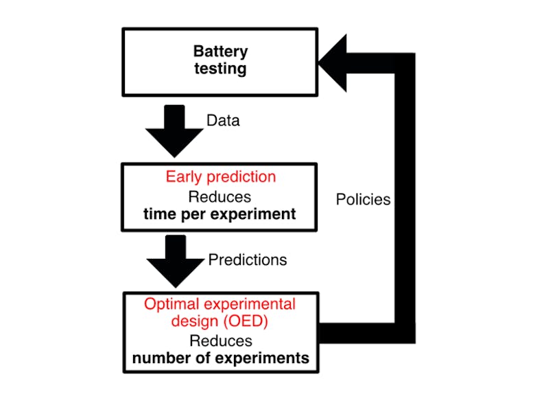

The resultant set of a several hundred million data points was used to train their model and the algorithm. This determined each battery’s state-of-health (SOH) and predicted how many more cycles each would last, primarily using data on voltage declines and a few other factors among the early cycles (Fig. 2). Note that battery SOH is a complex state involving two major characteristics of aging batteries (among other considerations): their progressive loss of storage capacity (called capacity fade); and the increase in internal impedance, which reduces the amount of actual power the battery can deliver to the load.
2. In the closed-loop optimization system, the battery-test batteries’ data goes to an early-prediction model. Those predictions are applied to a Bayesian optimal experimental-design algorithm, which recommends the next policies to be tested. (Source: Stanford University)
The team’s predictions were within 9% of the final number of cycles of battery life. Further, the algorithm was able to categorize batteries as having either long or short life expectancy after just the first five charge/discharge cycles, with these predictions considered to be correct 95% of the time.
