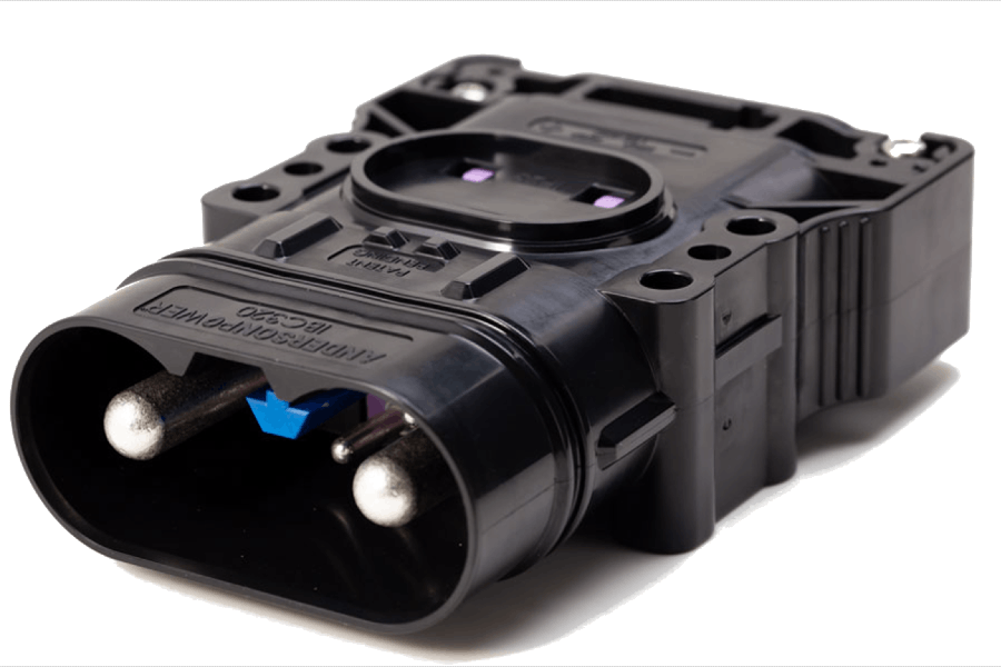

In machine design, connectors are essential components that facilitate electrical connections. As electrification expands across industries, connector design is undergoing significant transformation to meet rising demands for mechanical strength, environmental durability and electrical performance. Joe Ferris, market segment manager at Anderson Power, a maker of high-powered battery connectors, spoke with Machine Design about how connector innovation is enabling smarter electrification and addressing emerging challenges.

In response to labor challenges and the need for swift serviceability, Anderson Power’s tool-less cartridge design modularizes connector assembly. Ferris says that by moving complex wiring and contacts outside the confined connector housing, the system reduces assembly time, minimizes specialized tooling and facilitates rapid field repairs. And this design has proven impactful; some material handling customers reduce their repair team head count by two-thirds while boosting equipment uptime and revenue, Ferris said.
