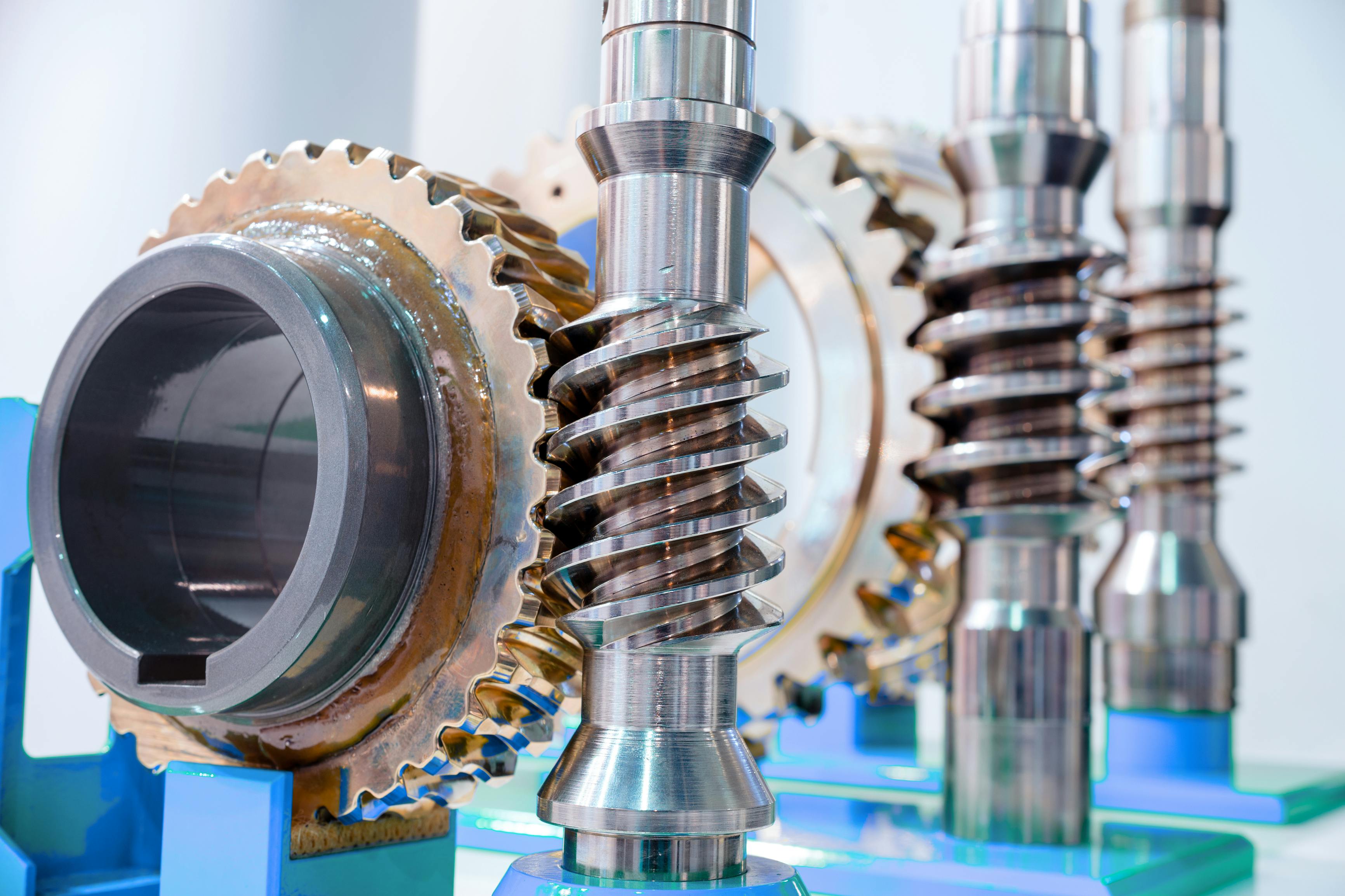

Worm gear reducers play a key role in mechanical systems due to their ability to achieve high gear reduction in a simple, compact design. This unique functionality makes them suitable for a range of applications, including hoists, conveyors and various machinery drives.
Worm gear reducers are “right-angle” reducers because their input shaft is oriented 90 deg. from the output shaft. This arrangement allows for a cost-effective, simple design that is quiet, rugged, shock-resistant and allows for compact conveyor and machinery arrangements.

Run-in. Typical worm gear reducers use a hardened steel worm driving a bronze worm gear. The efficiency of a new worm gear reducer is often less than a well-run-in reducer due in part to the fact that the gear teeth on a new worm gear are not smooth. They will have small hobbing facets on the flanks of the bronze gear teeth. The edges of these facets are high spots that can interfere with the generation of a hydrodynamic lubrication layer when the worm is spinning at the typical 1,750 rpm. A run-in period of 10 to 100 hours is typical for worm gears. During this time, the efficiency increases, and sump temperature decreases as the facets are worn smooth and “work hardening” occurs on the bronze flanks resulting in a more effective hydrodynamic lubrication film.
