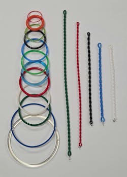

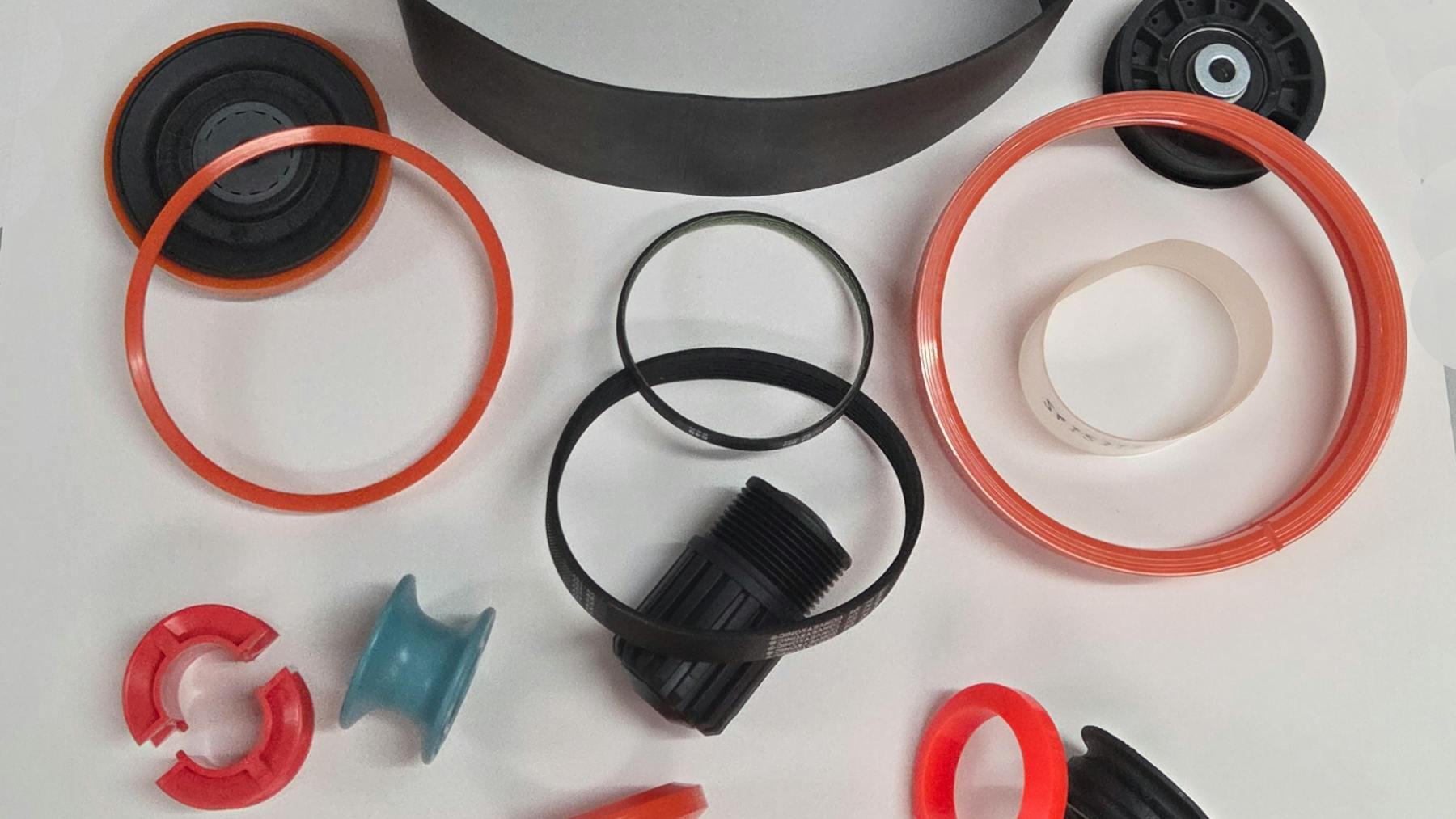

Jim Hammond: Dura-Belt manufactures thermoplastic elastic round, flat, twisted and V-belts designed primarily for conveying with Motor Driven Rollers (MDR). The majority of our belts are made from thermoplastic polyurethane (TPU). We also are master distributors of stretchy (slightly elastic) ConveyXonic poly-V, V-Conform and ConveyDyn belts that are also designed for conveying with MDRs. None are precision belts.
Timing belts and timing chains are made for precision positioning. They are made from inelastic materials, so they are designed not to stretch. They have teeth or cogs that fit into synchronized cogged pulleys or sprockets, so their positioning is very accurate. Therefore, they are used inside robots, whereas elastic conveying belts are used on conveyors in robot applications in conjunction with sensors and brakes that move containers in position for robots to grip and process them.

Our round “O-ring” belts are extruded, so they have the same amount of urethane on the outer diameter and the inner diameter, as opposed to injection-molded O-ring belts that have less material on the inner diameter. This means that unlike molded O-rings, our O-ring belts spiral like candy canes whenever they are misaligned or used on curves, so they likely last longer because they don't tend abrade and lift out of grooves or excessively wear like most other belts (except ConveyDyn D-shaped belts that slip fairly easily to stay in grooves).
