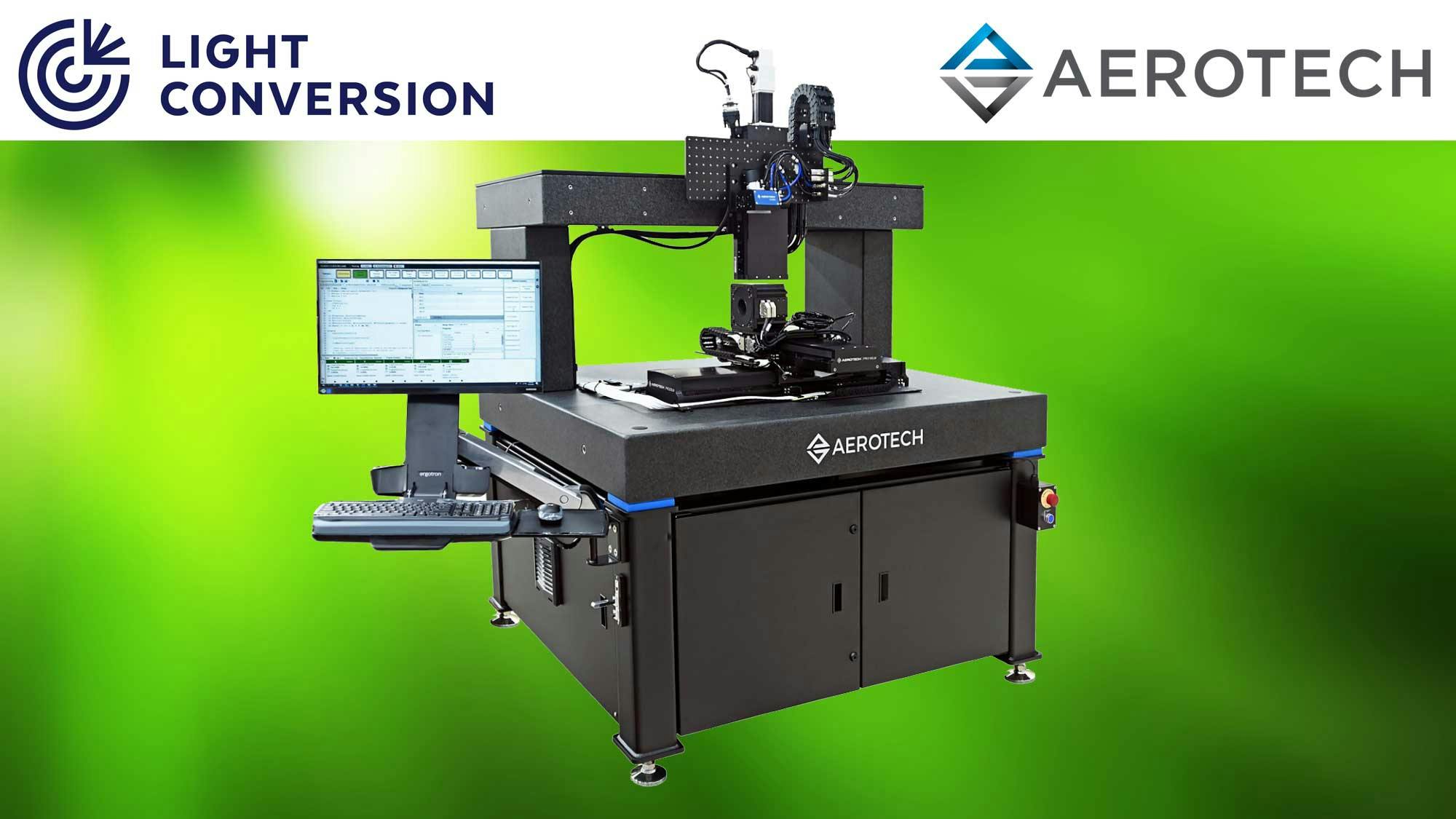

Aerotech Inc., a specialist in precision motion control and automation, has partnered with Light Conversion, a manufacturer of femtosecond lasers to establish an advanced research and development laboratory in Sunnyvale, Calif. The 43,000-sq.-ft. facility, operational since February 2025, is focused on advancing laser processing solutions for applications across semiconductor manufacturing, electronics and medical device fabrication.
The collaboration integrates Light Conversion’s Carbide 80W femtosecond laser with Aerotech’s custom laser scanning and motion control components. The system features an AGV-HPO high-dynamic laser scan head, designed to deliver high-speed acceleration and minimize trajectory errors during processing. The motion platform utilized Aerotech’s linear and rotary stages, which provide flexibility and accuracy for working with a range of part geometries such as round, tubular or flat substrates.
Key technical capabilities include Aerotech’s programming innovations such as Infinite Field of View (IFOV) and Position Synchronized Output (PSO), which enhance speed and precision to submicrometer levels without impacting throughput or quality. System control is centralized through a single Automation1 motion controller to streamline setup and operational efficiency.
The partnership leverages Light Conversion’s femtosecond laser technology and BiBurst pulse operation alongside Aerotech’s precision motion and scanner technology to explore novel laser micromachining processes. This enables targeted advancements in high-precision applications pertinent to semiconductor device manufacturing and medical technology sectors.
The Sunnyvale lab is equipped with diagnostic instruments such as microscopes to support detailed evaluation and development of laser processing techniques, including cutting, drilling, marking and material modifaction. The facility is designed to facilitate collaborative work with customers and partners addressing complex manufacturing challenges.
This technical collaboration aligns with ongoing industry efforts to push the boundaries or microfabrication precision and throughput by combing ultrafast technology with high-performance motion control systems.
