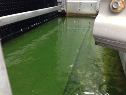

The basin was his next challenge. The residual solids left behind in a tower’s sediment basin make the perfect environment for Legionella growth and algae build-up, presenting a painstaking, hazardous expense. Curtis rejected the “necessary evil” of sediment basins, founding his new design on the premise that filters and separators were a much better approach to isolate solids before water enters the tower.
By incorporating a double-walled basin as an integral part of the tower bottom basin wall, water could move rapidly around the cooling tower perimeter at a high velocity (5 to 7 fps), keeping solids in suspension rather than letting them settle out as they do in a traditional stagnant sediment design. Getting rid of the external basin altogether, the design would use just enough water to ensure appropriate cooling, keep the solids suspended and use external filtration and or separation to remove solids.
The resulting FlowThru Basin was perfected in the early 2000s. This design effectively reduces algae and Legionella growth potential to zero and has an ultra-low debris entrapment rate compared to conventional crossflow and counterflow tower designs.
