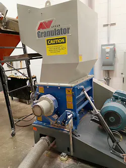

For years, the granulator’s control panel did its job with eight relays, five electronic timers, pilot lights, pushbuttons and a wye-delta motor starter. It mostly worked in a simple and adequate manner but it required a bit of electrical maintenance over the years and sometimes the granulator would become overloaded and jam up, requiring operators to clear it out manually.
Eventually, the wye-delta starter finally failed completely. Although one contactor was sourced to temporarily patch things back together, we saw this as an opportunity for more than a repair (Figure 1).
The granulator’s 50-horsepower, three-phase motor was energized in an old-fashioned way using a wye-delta starter. Instead of slamming the motor on at full power, a wye-delta starter provides a two-step way to start the motor, first at reduced current and torque to minimize electrical and mechanical stress on the equipment and then changing over to full speed after a period of time.
Wye-delta starting is an economical approach, but it requires three carefully interlocked contactors to operate in a sequence driven by relays and timers. This scheme relies on multiple ageing components to get the sequencing right and on this panel the wear was starting to show. Even though a quick fix was implemented, it was only a matter of time until the next part failed.

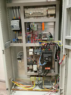

With the general solution settled, the next question was which automation platform would deliver the best performance and value, while fitting into a panel with limited room. The team has used AutomationDirect’s CLICK PLCs on past projects, but for this project, the Productivity1000 PLC fit the enclosure’s tight footprint better, while still leaving enough room to grow.
The platform’s support for descriptive tag-based addressing was also a factor, offering an alternative to the fixed memory addressing common in some legacy PLC systems. In addition, the programming software provided the instruction set needed for the application without requiring additional software licensing.
While this PLC family was originally only available in a stackable micro form factor, a more recent “mini” version incorporates some input/output (I/O) points right on board the processor to provide an all-in-one solution, with the option to add some more I/O modules if needed. This exactly met the needs for this project’s phased approach (Figure 2).

Tearing out the old relays and installing the new PLC would need to happen quickly, without the opportunity to pre-build a subpanel. To ensure that everything would go smoothly, we first pre-assembled the PLC and associated components on a sheet of plywood. We designed the PLC solid-state outputs to drive DIN-rail-mount interposing relays, which is generally considered a good practice when driving heavier loads like contactors because it provides a degree of isolation and protection for the output module. While the I/O module is relatively inexpensive and easy to replace, it’s much cheaper, easier and faster to replace a relay.
Debugging the sequence on the test bench was a crucial step before we considered heading out to the plant floor, especially to maintain the proper wye-delta contactor sequencing. Both the PLC and the HMI include simulation options that facilitated this. The hardwired safety interlocks between the three contactors stayed in place and the goal was to get the new logic behaving exactly like the old one before commissioning. We tested the new PLC logic extensively, along with its interaction with the HMI, which now provided much more information to the operators (Figure 3).
With testing complete, we proceeded with phase 1, installing the new PLC/HMI equipment with confidence. This changeover took just five days, and then we had the system up and running flawlessly.
