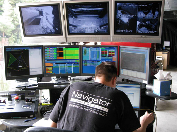

Look backstage at a big-time theater production and you are likely to see a console like this one running a specialized control program for moving stage elements.
