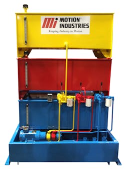

In the final stages of production, this custom-designed fluid containment system for a mining operation lets end-users identify and segregate each fluid by color to avoid any possibility of cross-contamination. (Credit: Motion Industries)

Proper lubrication storage and transportation is critical. This is why setting up protocols for them merits a significant investment in time, effort, and money. Color-coded tagging of containment and transfer equipment keeps storage clean and orderly. Positioned throughout a facility, this serves as a daily, visual reminder of that facility’s commitment to the program. It also cultivates a culture among the employees that values good maintenance.
A widespread misconception that new oil is clean often leads to premature failure. The reality is that new oil will only have a minimum level of cleanliness. This level, typically provided in the ISO format, should be compared to requirements for the linear bearings and guides. It will show that new oil is not clean—or at least, not clean enough. The best way to combat this is to always filter lubricants when they are transferred from a barrel to bulk storage, from bulk storage to temporary containers, and from temporary containers to the equipment being serviced.
Designers should focus on:
  • Installing and storing lubricants, bulk storage tanks, and transfer equipment in one clean area, preferably one with environmental controls that minimize the escape of airborne contaminants, stabilize temperatures, and control humidity. Placing this area in a location central to the facility, ideally near a storeroom or maintenance shop, saves time and labor by creating an efficient workflow.
  • Color code everything: storage tanks, transfer equipment, and even the equipment being serviced. For example, it would be a good idea to have a yellow grease gun, yellow outlined pegboard in a bulk-lubricant storage area, and a yellow tag showing the grease name and type hanging on all equipment it gets put in or on. Color coding for lubricant distribution makes for an easy-to-use and intuitive system. It may seem like a laborious task, but there are many ready-made labels and tags that can be quickly and easily ordered and installed.
