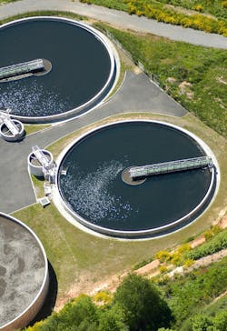

Bearings in submerged pumps and agitators found in pulp mills, as well as in petrochemical and waste-treatment plants, are typically lubricated by the working fluids. But intermittent operation and varying working-fluid levels may starve bearings, which is a problem because grease and oil lubricants aren't an option. Graphite/metal alloy bearings, in contrast, can operate dry for over 50 hours in some cases until fluid is reintroduced.
