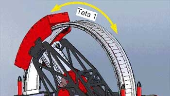

Creating a robot for small parts handling calls for a machine design that is both highly dynamic and extremely precise. With the Galileo Sphere, the Italian Mechatronic System Company has built a robot that combines the advantages of linear and direct drives in one system. The curved linear motor at the bottom (Teta 2) enables full rotation of the robot, while the second linear motor (Teta 1) lets the robot arm pivot by more than 68°. The actual arm (Z1, Z2) is made up of two iron-free linear motors, each moving one carbon rod on which the wrist joint (Teta 3) is attached to the gripper. The gripper consists of a vacuum sucker that can be rotated around its axis using a compact motor, an arrangement allowing five degrees of freedom.
