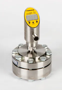

Application challenge #1: The media being measured clogs the sensor.
In extreme applications, accessories such as a diaphragm seal can be added to isolate the sensor from the media being measured. When choosing a diaphragm seal, look for designs with large open areas that will resist clogging, and a cleanout port to facilitate the removal of material buildup.
While pressure measurement is a fairly straightforward concept, the media which is being measured can vary in numerous ways. In most instances, the media is as ideal as clean air or water, but there are applications where media can have debris mixed in, such as contaminated coolant or slurries. If not managed properly, the media can clog the measuring cell on the pressure sensor, causing the sensor to improperly measure the force being applied. This often results in damage to system components.
The ideal solution is either to filter the media before it reaches the sensor or isolate the media from the sensor. In many cases, filtering the media is not possible or practical, but engineers can solve this problem through sensor product selection.
In extreme applications, accessories such as a diaphragm seal can be added. Diaphragm seals are liquid-filled devices that isolate the sensor from the media being measured. Look for designs with large open areas that will resist clogging. Another feature to look for is a cleanout port, which allows a separate connection specifically designed to facilitate removing material buildup.
In some applications, using a diaphragm seal is not an option. In these cases, select a sensor that allows unobstructed access to the measuring cell. This design will not eliminate clogs, but can minimize the likelihood of clogs that cause unwanted system downtime.
