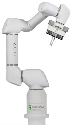

The OB7 is the new cobot on the block and has an impressive seven movable joints.

Another point that differentiates us from the majority of our competitors is that OB7 has seven moveable joints, while most collaborative robots have only six. Having seven moveable joints results in increased maneuverability and allows OB7 to better reach in and around the work area. For example, with seven joints we can put OB7 to the side of a work area and it can reach in, still allowing room for people. With six joints, the robot must be centered in the work area, dominating the space.

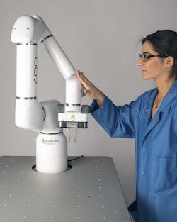

For the OB7 to be classified as a cobot, it must be safe when it comes into contact with its human operators. The image above demonstrates how the OB7 will stop when it hits a hand.
