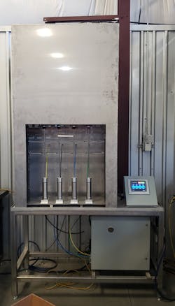

Several positioners from Anysize can be controlled by a single air line. Each positioner has only one moving part, the piston.

Because the positioner we were developing would be used in applications required hundreds of them acting in unison, air pressure was chosen, because changing pressure in a single line changes the pressure going to each positioner at the same time.
Moving beyond Westinghouse’s invention, we precisely match the springs and the pressure so that the positioners continue to move in unison to a desired position. In essence, pressure equals position. A long line of Anysize positioners can easily be controlled by a manual pressure regulator and recent developments in proportional pneumatic regulators make it possible to precisely control air pressure electronically from a PLC and integrate hundreds of positioners into a system.

The average Anysize system consists of 300 positioners, most move to a position and stay there for a day or more. It takes approximately one cubic foot of air at 80 psi to move to a position. Once in position, it takes no energy to hold position as long as common practices are followed to minimize air leaks.
