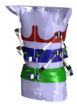

The Robotic Spine Exoskeleton (RoSE) consists of two six-degrees-of-freedom, parallel-actuated modules connected in series, each with six actuated limbs. (Image Credit: Sunil Agrawal/Columbia Engineering)

The RoSE was developed by Agrawal’s Robotics and Rehabilitation (ROAR) Laboratory and consists of three rings placed on the pelvis, mid-thoracic, and upper-thoracic regions of the spine. A six-degrees-of-freedom, parallel-actuated robot is used to control the motion of two adjacent rings.
The system has 12 degrees of freedom overall that is controlled by 12 motors. With the RoSE, researchers have the ability to control the motion of the upper rings with respect to the pelvis ring or apply controlled forces on these rings during the motion. The system design can also apply corrective forces in specific directions without restricting the free motion in other directions.
