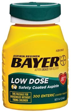

Taking the headache out of packaging
Each TPE-covered cap is color coded to match the graphics of each SKU, making it easier to identify the various strengths of aspirin.One example of the role TPE can play comes from Bayer Consumer Care, a division of Bayer HealthCare in Morristown, N.J., which in 2009 introduced new packaging for a line of aspirins. Its main objective was to create an easy-open bottle for arthritis sufferers.
The bottles are now larger, sleek, and oval shaped. They are made from high-density polyethylene (HDPE) while the caps are covered with a soft-touch, rubberlike TPE. The TPE makes the bottle easier to hold and twist to remove from the cap. These caps are made using a bi-injectionmolding method where TPE is molded onto a polypropylene substrate.

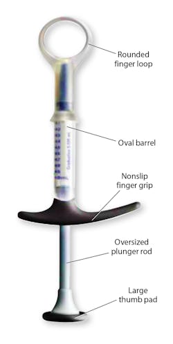

Patient-operated tools
Most syringes are designed to accommodate the expert practitioner rather than the patient who receives the contents. But with a graying population, more patients are being treated at home and controlling their own injections.
The Cimzia syringe has been awarded an “ease-of-use” commendation following vetting by the Arthritis Foundation.OXO, a consumer products company in New York City, and UCB, a pharmaceutical company in Atlanta, created a prefilled disposable syringe to help with self-administered injections. The design of the Cimzia syringe incorporates various ergonomic improvements to make the injections as easy and safe as possible. For instance, the finger holds are extra wide and made of soft, nonslip TPE. The plunger has a big, easy-to-push thumb pad. The needle cover is designed with a rounded finger loop for easy removal. It also has a flared edge that reduces accidental needle pricks when the syringe is recapped.
Other alterations were made to help those with poor eyesight. The barrel is magnified to make dosages easier to read and help patients see when they’ve injected the entire dose. The barrel is also made in the shape of an ellipse to make it less likely to slip. The syringe comes with instructions accompanied by clear visuals for those who can’t see small print. The packaging is a plastic housing with large finger wells and includes hook-and-loop repositionable tabs for easy opening.

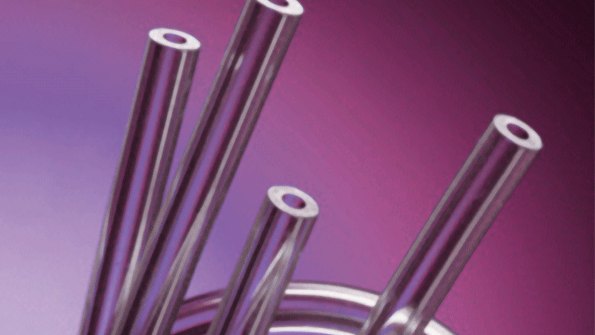

TPEs can be processed using thermoplastic processes with lower cycle times than thermoset rubbers. This makes them an alternative to thermoset rubbers such as silicone and butyl rubber. They can serve in numerous medical applications such as stoppers, gaskets, and tubing. They can also replace flexible plastics such as PVC because they can be processed using the same equipment.
