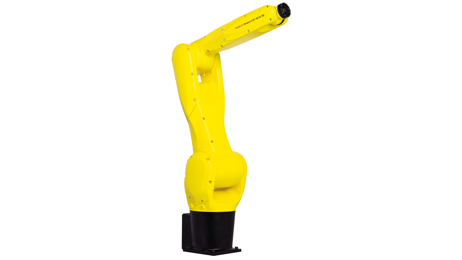

The LR-10iA/10 robot
Compact Robot Mounts at Any Angle
Dec. 7, 2021
FANUC's offering is designed for machine tending and a variety of picking applications.
The LR-10iA/10 robot designed for machine tending and a variety of picking applications found in the warehousing and logistics markets. Weighing just 46 kg, the LR-10iA/10 robot mounts to the floor, upside-down or on an angle. It’s also very easy to mount the robot to an AGV or other mobile platform to accommodate a variety of repetitive tasks or automate machines that are standing idle.
The LR-10iA/10 has a 10 kg payload and a large work envelope with a long reach of 1,101 mm. Its compact size makes it an ideal solution for companies with limited floor space, and the slim arm fits into machine tools to load and unload parts. In addition, a fully enclosed structure features built-in airlines, solenoid valves and electrical utilities for easy integration, and an IP67 rating allows it to operate in industrial environments with dust, water and oil mist.
