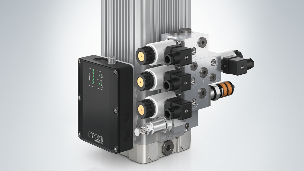

The INKA intelligent compact power unit is equipped with many standard technical highlights. The attached electronic communication box with integrated real-time operating system enables the acquisition and storage of operating data, extensive diagnostic options and a self-test for all measuring functions. The measured values of the integrated multi-sensor, including the motor speed, can be transmitted to the higher-level machine control system via an IO-Link interface. In the software, the calculated volume flow, the running time of the unit and much more can be displayed via the motor speed.
The software also enables the digital creation of variants of the INKA with switching outputs, which is very interesting for flexible adaptation to different machine types by the OEM himself. The status messages of the integrated multi-sensor on oil temperature, fill level and general condition of the unit are also displayed at all times via the LEDs on the communication box.
