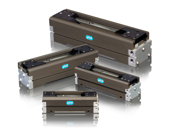

Series GRH parallel pneumatic grippers provide long jaw travel while accommodating long tooling lengths. Available in four sizes, the grippers have an extended support guide system with wide slot jaws to minimize tooling deflection, support large moment capacities, and provide side-load stability. A dual bore provides higher total grip force, and low breakaway pressure allows for gripping of a wide variety of part sizes, including delicate parts.
Jaw travels up to 125 mm (4.921 in.) for gripping larger and multiple-sized parts.
