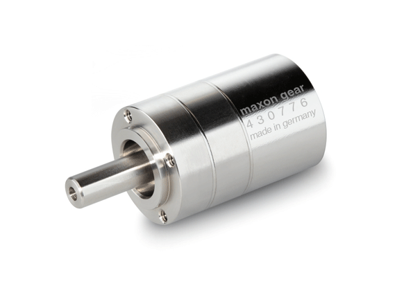

The company’s new GP 19 M sterilizable planetary gearhead is for applications requiring input speeds of up to 40,000 rpm. To accommodate these speeds, the toothing and materials have been designed to minimize friction. A key material demand is 1,000 sterilization cycles. The gearhead contains a special shaft seal. Users need not disassemble the drive for sterilization.
