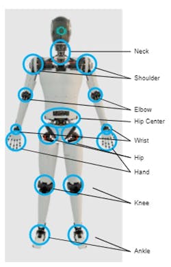

Designing robots requires precision and flexibility. When creating a humanoid robot system, there are mechanical and electrical considerations that you need to understand before beginning the actual design.
Sponsored Resources
The Robot Motor Drive Block Diagram building blocks to make it happen include:
Motor types. When high power levels are needed, humanoid robots can incorporate motors such as permanent magnet synchronous motor (PMSM, a brushless AC motor that uses permanent magnets in its rotor to create a magnetic field). There are two options for PMSM motors: trapezoidal or sinusoidal winding. This choice of winding (and the control algorithm) affect how precisely the motor is controlled.
Brushed DC motors can be used in some low power cases such as hand and finger control. Product miniaturization has an effect on motor selection for many applications and there is associated complexity of the motor control and position feedback to achieve precise motion.
