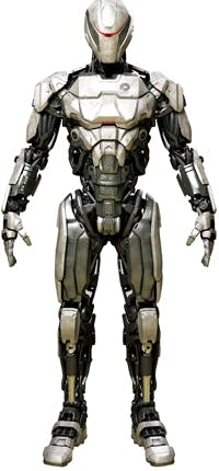

“Designing the costume, we had to fuse aesthetics and functionality,” says Whist. “It had to look like man in a machine, not a suit on a man, and we weren’t CGI’ing it. So it had to work with a human in it. And we had to construct it, so we had to temper our imaginations with the fact that it would be built and worn, and still had to look cool.
“The suit is made of maybe 150 parts, which are assembled into about 10 larger subassemblies so it can come on or off more easily,” he says. “In the story, the suit is made of graphene, a superstrong and lightweight form of carbon currently being explored in labs. But if the suit were really graphene, it would be so flimsy and ethereal that RoboCop would look light on his feet. For the sake of the story and visuals, and so it would have a presence and real mass, especially when he was fighting, we made the RoboCop suit look more like armor or shielding.”
Characters in the movie had similar problems. When RoboCop is first brought to life, he sports a silvery mechanical skin, a sly wink to the original. But those in charge of RoboCop wanted him to look more menacing and lethal. So the scientists and technicians in the movie give RoboCop a darker, more-intimidating makeover.
“The silver suit was a tip of the hat to the original, with the same color and several similar components,” explains Whist. “The second, darker suit is inspired by the creature designed by Swiss artist Geiger for the movie Alien, as well as the stealth bomber, and Formula 1 racing cars. It has an aggressive, contemporary design that is organic, aerodynamic, and sculpted.”

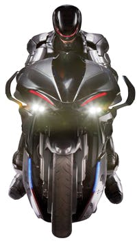

“The suit was first designed in a computer. Then parts were ‘grown’ using 3D printing or cast in plastic or resins, depending on whether the part had to be stiff or flexible. Movable joints were constructed out of foam. There is very little metal,” says Whist. “The actor is completely inside it, but he can maneuver. For example, in most of the scenes with RoboCop on a motorcycle, a stunt man wears the full costume while actually riding the bike.”
The costume also didn’t weigh much more than an ordinary suit of clothes, but it did fit tightly. The tight fit meant Kinnaman, as well as his stunt doubles, had to meet certain requirements. “We cast for a lean, dexterous actor with the build of a triathlete,” explains Whist. The suit adds the muscles and inches. Kinnaman is 6’2” but the costume makes him 6’8”.
RoboCop gets a custom motorcycle in this version of the movie. The bike obviously shares some styling cues with RoboCop’s outfit.
