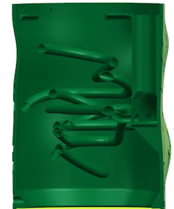

Jagodinksi said one of the most enriching parts of the collaboration for her was working with the zoo’s insect department to identify the size and shape of the tube through which the cricket could crawl. “We printed three tubes with three different diameters and took that to the zoo,” she said. “We put it into an enclosure with a bunch of crickets and just saw what happened.”
There was some back-and-forth once the first CAD model was designed. COVID-19 slowed down the process since both the zoo and GE were partially closed, but GE will deliver two more working devices as well as an additional device for educational purposes, which will remove part of the exterior so visitors can see inside the additively manufactured tree trunk.

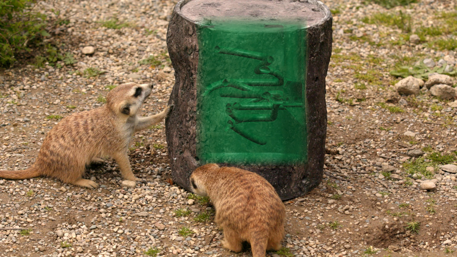

The feeder was printed using electron-beam technology, a process of additive manufacturing that uses a high-power electron beam to generate energy for a high melting capacity. GE and the zoo selected titanium due to its non-corrosive and non-impactive nature. The design had to be heavy enough to prevent an animal from tipping it over, but it also had to be light enough for a keeper to easily pick up and move.
The outside structure resembling tree bark was designed and extruded in GE’s 3D CAD package to create a texture similar to wood. The device has been placed inside the zoo’s aviary, meerkat and night hunter habitats.

Orban said the feeder said the collaboration was a resounding success, even considering the crickets’ reluctance to exit the feeder on hot, sunny days. That scenario allows animals to feed at night—a time that keepers are not even in the zoo.
“One of our primary goals was to extend foraging time,” he said. “Part of that time is the investigation—you have to find your food. It has been successful. We’ve seen that in all the species we’ve tested with.”
