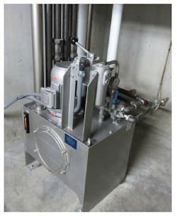

A central oil reservoir helps keep the machinery cool.

The stacked arrangement lets Legg use shorter driveshafts, but the weight of the stacked units made the overall machine difficult to install. A cast-iron supports lets the stacked units take most of the compression loads, which especially affects bending moments and the bottom case of stack. This additional support ensures the attachment flanges are not overstressed. A central lubrication subsystem fed from a remote reservoir helps control thermal loads.
