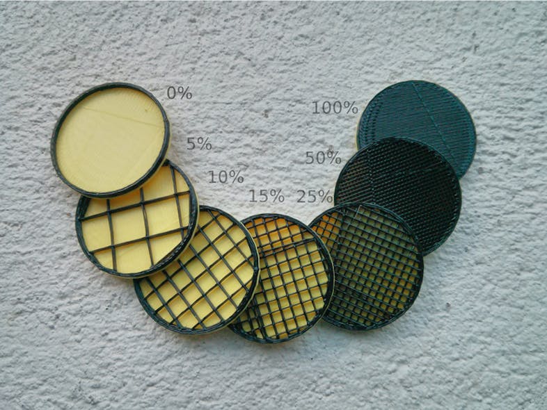

What does the infill of a 3D printed object mean? How much do I need to use and how do I decide?
Elsworthy: Infill means how solid the model will be–in 3D printing terminology, this is known as “% Infill.” By selecting different levels of infill, users can decide how dense they want their print to be. Users who want their finished print to be very robust should choose a high level of infill, while users who want to print something quickly while also using up as little printing material as possible should choose a lower level.
1. Maker Ware profiles what the different percent fills look like. There are other shapes that can be made for different reasons – mechanical properties, weight, print speed, etc. (Photo courtesy of thingiverse)
The infill is mainly for support and mechanical properties so the layer thickness or resolution is not as important. Depending on the software’s options, it is possible to increase the thickness of the fill while maintaining the same exterior layer resolution. This will reduce your print time without sacrificing any mechanical or aesthetic qualities. In general, infill is linearly proportional to strength.

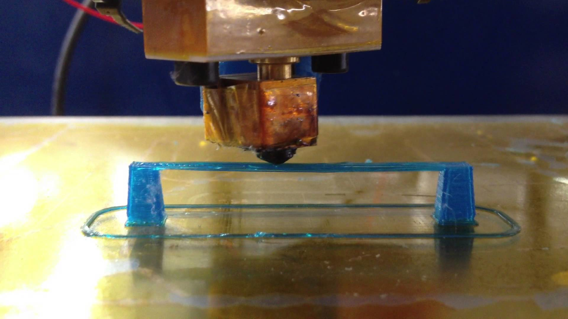

Should I just always activate support material when I print? It’s hard to tell what needs it and what doesn’t.
Elsworthy: Support material should only be activated when there are overhangs over 45 deg. or where there is no material beneath a particular point on a model. Overhangs can be built up without support material, called “bridging,” making it difficult to get accurate, repeatable parts. If you control speed and resolution with accurate cooling (a cooling fan will be necessary), this can save time and support material.  Overhangs can be overcome by printing the model at a different angle (so with a different side as the base), or where this is not possible, by activating support material. Larger (closer to horizontal) unsupported overhangs are possible as layer height reduces, as the thinner the layer height, the smaller the “step out” on each layer in relation to the nozzle diameter, allowing them to be more easily supported by the previous layer.
3. Overhangs and bridging can be difficult, but can save a lot of material and time fi they can be printed accurately. The void under this expanse would have to otherwise be filled with filler material or structural supports that would take time to print then have to be removed in post processing. (Photo courtesy of BCND Technologies)
