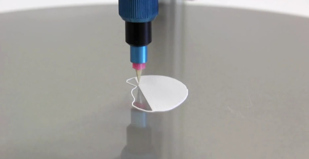

1 Having the first layer stick to the build tray can be more difficult with a finer nozzle

For fused filament fabrication (FFF), properly printing the first layer is important. Often blue painter’s tape is said to be beneficial for making part removal easy and to help the first layer stick. However, if the bed is heated, the tape may not stick. Tape peeling from the build tray or overlapping can provide an uneven surface, which can cause dimensional instabilities and other problems. Also, using a heated bed, even for materials that do not require one, slows the cooling rate. This can prevent excessive shrinking, warping, and delamination from the build tray. Here are some suggestions to help you make the first layers stick.
  • Check operating temperatures: Different materials have different melt and glass transition temperatures. Even switching can alter these temperatures. Heating elements in the bed may not achieve the proper temperatures. Putting a cloth or thermal insulating material over the bed until you are ready to print can help get those few extra degrees that might make the difference in firs- layer quality.
  • Check the build tray: Make sure the build tray is clean. Oils or small debris can affect the adhesion of the first layer.
  • Level the build tray: An offset build tray can cause not only a poor first layer, but can cause the print to fail completely later in the printing process.
  • Turn off the fan: This will help to reduce rapid cooling that can lead to poor bonding
  • Surface finish: Hairspray and sandpaper can help parts stick to the build tray, but there is another way. This technique comes with a caution as it can weld the part to the surface of the build tray if not done properly. Using acetone on a failed print and wiping the print on the build-tray surface will put down a layer of the polymer you are about to print with, and provide an easier surface to stick to. A little acetone and a light layer to keep parts from becoming welded to the build tray.
  • Slow the printer speed for the first layer: It is not desirable to slow the speed, but it can help ensure the material is properly heated and pressed into the build tray.
  • Use the brim feature: Brim is when a larger base layer is printed like a base flange around the base geometry that provides more surface area to be in contact with the bed. This can help the print to stick to the build surface and reduce warping. This is also suggested for tall prints with minimum surface contact with the build tray.
  • Adjust the Z-offset or flow rate: By adjusting your Z-offset you can flatten the first layer, increasing the contact surface between the first layer and build tray. This can be done by increasing the flow rate. However, adjusting the flow of material may cause more problems with accuracy, and may not allow the materials to reach proper temperatures. Adjusting the Z-offset is preferred. After making adjustments, watch the print to see if the nozzle is dragging through the material. Dragging is a sign that the offset or flow is not set properly, and can also contribute to poor adhesion and poor prints. This technique is like adding a small brim on the part without turning on the feature. If this works you may want to consider a brim. Make sure the adjusted properties are only for this first layer otherwise it could result in a poor or failing print.
  • Thicker first layer: Making a thicker, or lower-resolution, first layer can be great in case you are printing on an uneven surface, on top of an existing piece, or have problems removing it from the build tray. Thicker layers allow extra material for post processing to fix any surface finish problems that might have occurred during removal. Again, make sure the adjusted properties are only for this first layer.
