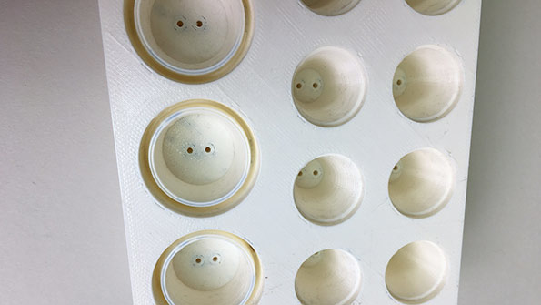

Another usage for 3D printers involves making negative or positive molds for thermoset or even thermoplastic parts. The 3D-printing molds for prototypes can lead to the material’s properties being closer to the production part than is possible when 3D printing the part directly. The accuracy of 3D molds is good enough to produce threaded inserts and two-part molds.
This part is used for molding thermoset urethane parts.
Creation of thermoset parts, using materials such as epoxy and urethanes, is pretty straightforward. You print a negative of your part, pour in the liquid, and wait for it to set. The end result is a finished part. Think of Jello molding.
