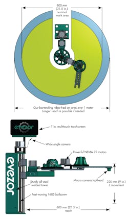

In its infancy, the Evezor was modeled after the SCARA (Selective Compliance Articulated Robotic Arm) assembly robotic design, which features a parallel-axis joint layout with a rigid arm in the Z-axis and an articulated joint on the X/Y axis—much like a human arm with reduced DOF (degrees of freedom).
This layout gives the robotic arm both an extended range of articulation (in the case of Evezor, almost a 3-ft. radius) and the ability to retract up into a folded position, allowing for a small footprint and making it ideal for the job functions mentioned earlier.
The Evezor robotic arm boasts an all-metal steel skeleton outfitted with several Nema 23 motors for articulation while riding a fast-moving 1605 ball screw. The sturdy frame can accommodate the modular-like interchangeable tool heads, some of which can weigh more than 6 lb. These attach to the metal-slotted end of the arm, which features an array of mounting holes for easy tool connection. Since the platform is open-source, users can design and create their own tool heads to go beyond what the Evezor already offers to benefit future endeavors.
Under the hood, the machine packs a Raspberry Pi to control the show with a 7-in. touchscreen (800 × 480) display for the user interface. A pair of cameras (RPi and wide-angle) provide vision processing, while motion control is handled by a SmootieBoard for accurate positioning. As far as software goes, it’s unknown what the Evezor employs. Wingate noted, however, that the platform is derived from the 3D printing community and has RepRap DNA. Considering that it’s open-source, you can use whatever software platform you desire and tailor it to your own needs. Wingate does offer the CAD files hosted on Onshape for those who want to build their own robotic arm, as well as the source files on GitHub.
