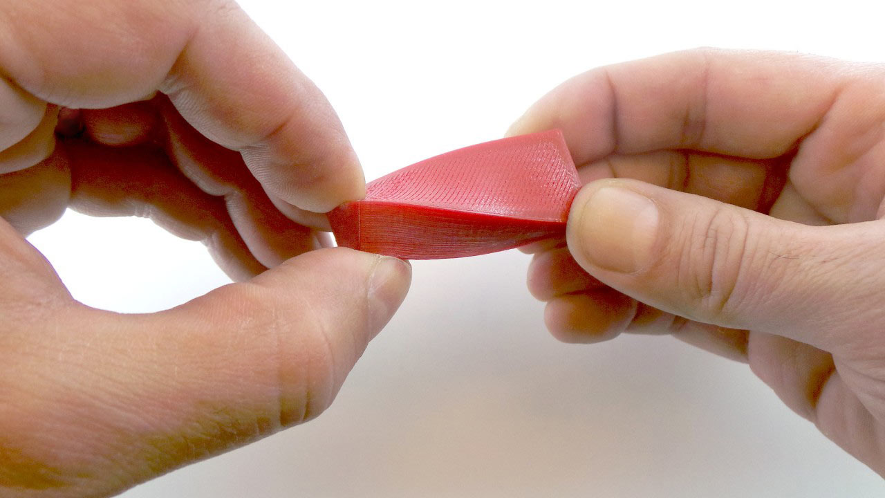

Michigan University’s Dr. Joshua Pearce does a lot of work on 3D printing. Recently, he published a 20-page report, "Distributed Manufacturing of Flexible Products: Technical Feasibility and Economic Viability,” showing the return on investment (ROI) of 3D printing at home. In the report, he walks through 20 common flexible household products, postulating that by simply 3D printing these products rather than buying them, a 3D printer could pay for itself.
Flexible products add a bit of a challenge. When considering a ROI on your printer, the filament can cost three times that of normal filament. Also, there might be modifications to the extruder, or the need for a completely new extruder to obtain better prints. This all adds to the cost of the parts making a ROI difficult. Despite this, the report suggests there is still a beneficial ROI to 3D printing flexible parts.
The main factors that were considered was the cost of the materials consumed (NinjaFlex), and the cost of the electricity consumed running a Lulzbot Mini. The use of flexible filaments requires special hardware to obtain successful 3D prints. The report added that extruders for flexible filament demand a direct path to the hot end, with no open areas where the filament can kink.
Several extruder options are available for flexible filament. The simplest option being to use a polytetrafluoroethylene (PTFE) tube that is the exact size of the filament (either 1.75 mm or 2.85 mm for the two most common filament diameters) to create a direct path from the drive gear to the hot end. This is the least expensive option, but also requires non-trivial technical knowledge.

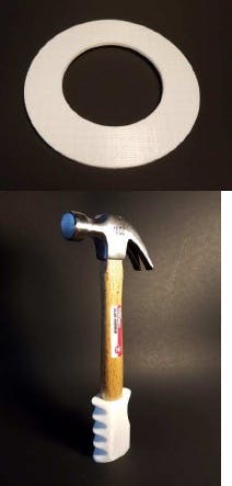

2. The 2-in. gasket was made with a soft silicone; it was difficult to match the same feel with the flexible filament. However, in the short term testing the gasket did perform without leaks. The grip on the hammer could also be adjusted by adjusting the infill depending on how much crush, or “squishiness,” the user wants.

The results of the parts were successful when tested over a short duration. The main drawbacks where noted that on the larger items the layers were more visible; this might hinder aesthetics of the product. In addition, flexible filament can be difficult to replicate parts made out of softer materials such as silicone.
The report also mentioned that NinjaFlex is generally more challenging to 3D print with than hard thermoplastic polymers. Not only does it require the additional equipment, but the print speed must also be reduced. Printer speed will be reduced roughly 3.5× slower when printing flexible material compared to traditional filaments. This makes all prints significantly more time consuming.
