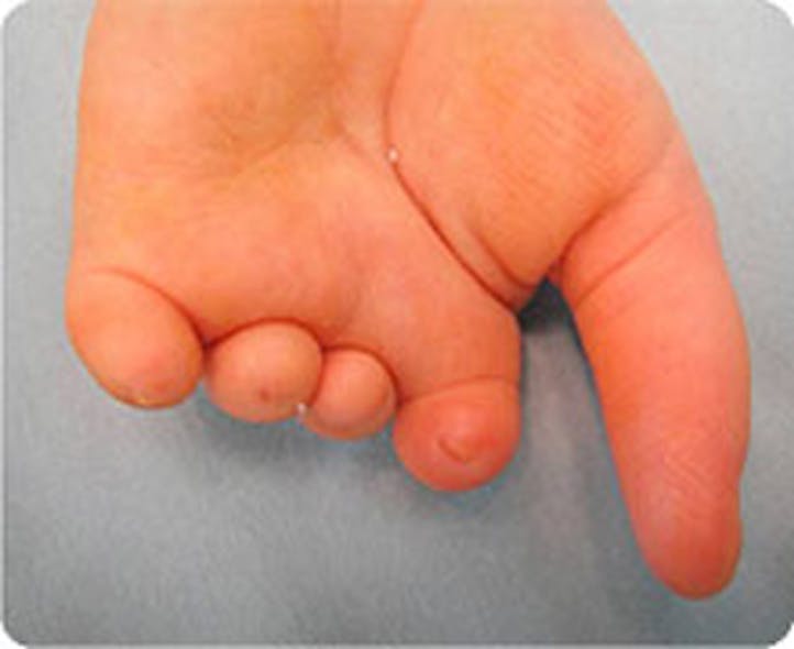

Symbrachydactyly it is a congenial disease that can lead to babies being born with no fingers, or short fingers, typically on one hand. Making prosthetics for growing children can become too costly, but thousands have now been helped with 3D printing and organizations like e-Nable.
Prosthetics have been changing many lives. There are millions of people afflicted with diseases or injuries that have cause the loss of a limb. In many of these cases custom prosthetics are not an option. Babies will grow out of an expensive prosthetics faster than they outgrow clothes, and at potentially thousands of dollars per prosthetic, this is not feasible. In undeveloped and/or war-torn areas, access to care and the money needed for prosthetics aren’t easily accessible.
