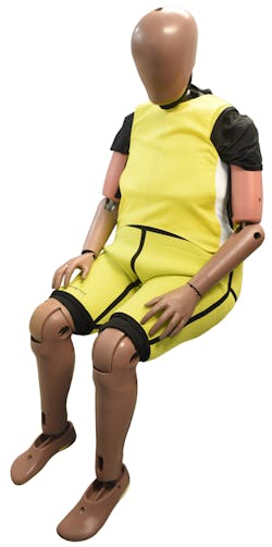

Research has shown that elderly occupants are more likely to sustain internal injuries during certain crash scenarios; bones are more fragile and soft tissues less robust. To reflect this, a new dummy captures the biofidelic nature of a 70-year-old female, 161 cm in height and 73 kg in weight—and is expected to have a significant impact on how the vehicle-safety community measures impact responses in crash events.

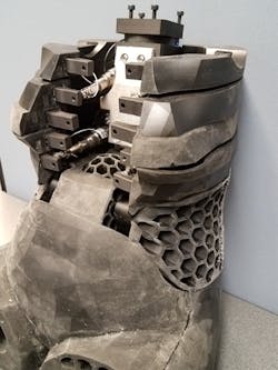

An interior view of an elderly dummy structure. (Courtesy of Humanetics)
Sullenberger researched other solutions and reached out to Adaptive Corporation – an adaptive digital-to-physical product lifecycle company. It suggested they consider using Markforged’s Onyx, a carbon-composite material reinforced with continuous Kevlar fibers.
Crash dummy torso showing 3D-printed components. (Courtesy of Humanetics)
The material met Humanetics’ specifications. They ordered a complete set of ribs, put them on an elderly dummy and conducted 60-70 impacts with no visible deformation or damage. “We’ve inflicted over 150 impacts to those Markforged-produced ribs to date,” Sullenberger says. “And we haven’t broken a rib yet.”
