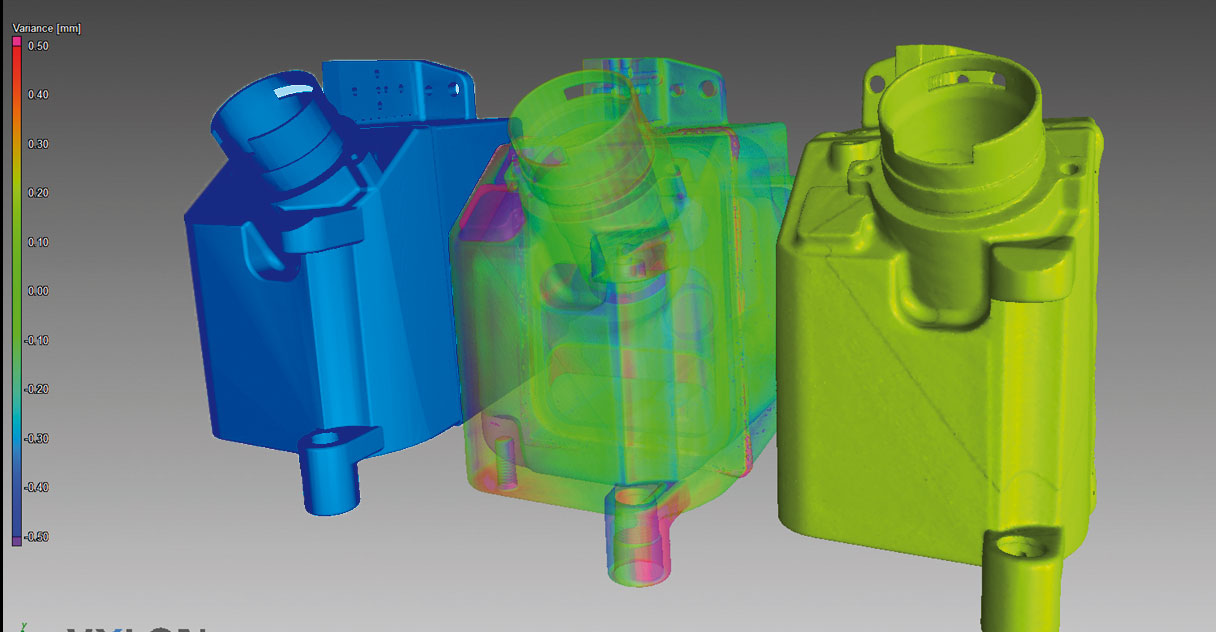

Once the part is in the system and the parameters are set up, a click of a button starts the scan. After the scan is complete, features can be measured with 3D measurement software. The measurement strategy for the features can be determined after the scan and the part can be used for further evaluation, if necessary. CT covers the entire part, including internal surfaces.
The Geometric Dimensioning and Tolerance (GD&T) features can be created after the scan. When the measurement template is created, it can be applied to other scans and then reports are generated for evaluation. With CMM, this is often not possible and usually involves re-measuring the feature. Occasionally, there are simply no other methods available to generate the required data. Very often cutting the part changes the geometry and leads to inaccurate results. CT is a non-contact, non-destructive method that doesn’t touch or change the geometry of the sample.

- High resolution surface model => actual vs. nominal comparison of entire surface including internal walls
