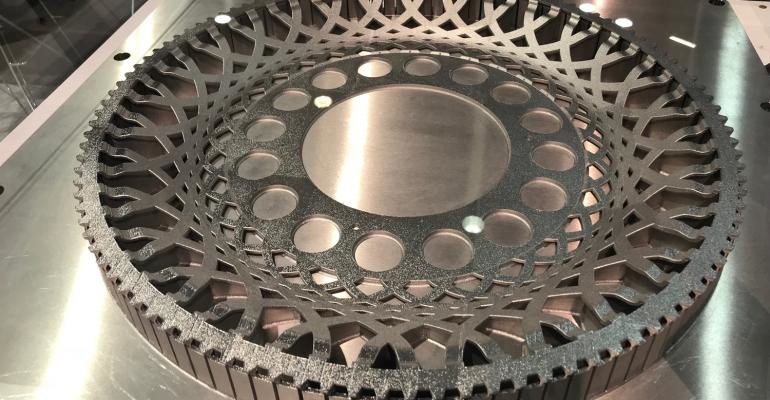

HP Metal Jet launched this year, and as with the Jet Fusion, it looks like HP hit the ground running. The Metal Jet is not the first printer like this—Desktop Metal and others offer binder jet process machines. This is a great way to produce parts quickly, and may help companies increase the break-even point on the return on investment when compared to traditional processes.
The main concerns with the binder jet process are the strength of the final part, post-processing, and supply chain. In addition, it is difficult to enter the metal printing world due to the startup cost. You regularly see GE and Concept Laser, Stratasys, Markforged, and now HP working in 3D-printed metal. However, as we learn more we might see more people playing in this market. Xact Metal started on a shoestring budget compared to the bigger companies, but they have already gotten a lot of attention.
Xact Metal was able to produce two models in less than a year: a large version for $120,000 and a smaller version for $80,000. The main difference in this laser powder bed process avoids the use of complex rotating galvanometer mirrors and F-theta lenses.
In traditional laser-based powder bed fusion 3D printers, at least one powerful laser is directed at a series of galvanometer mirrors, which rotate quickly to bounce the beam at a bed of metal powder and fuse the particles together. Although the mirrors are small, the mirror systems themselves are bulky, heavy, and expensive to buy and maintain.
Xact Metal has done away with the galvos and replaced them with what the company calls the “Xact Core”—an X-Y gantry system which sees lighter, less expensive mirrors mounted onto a gantry that moves them in the X- and Y-axes above the powder bed. This keeps the laser at a consistent perpendicular angle to the working surface.
