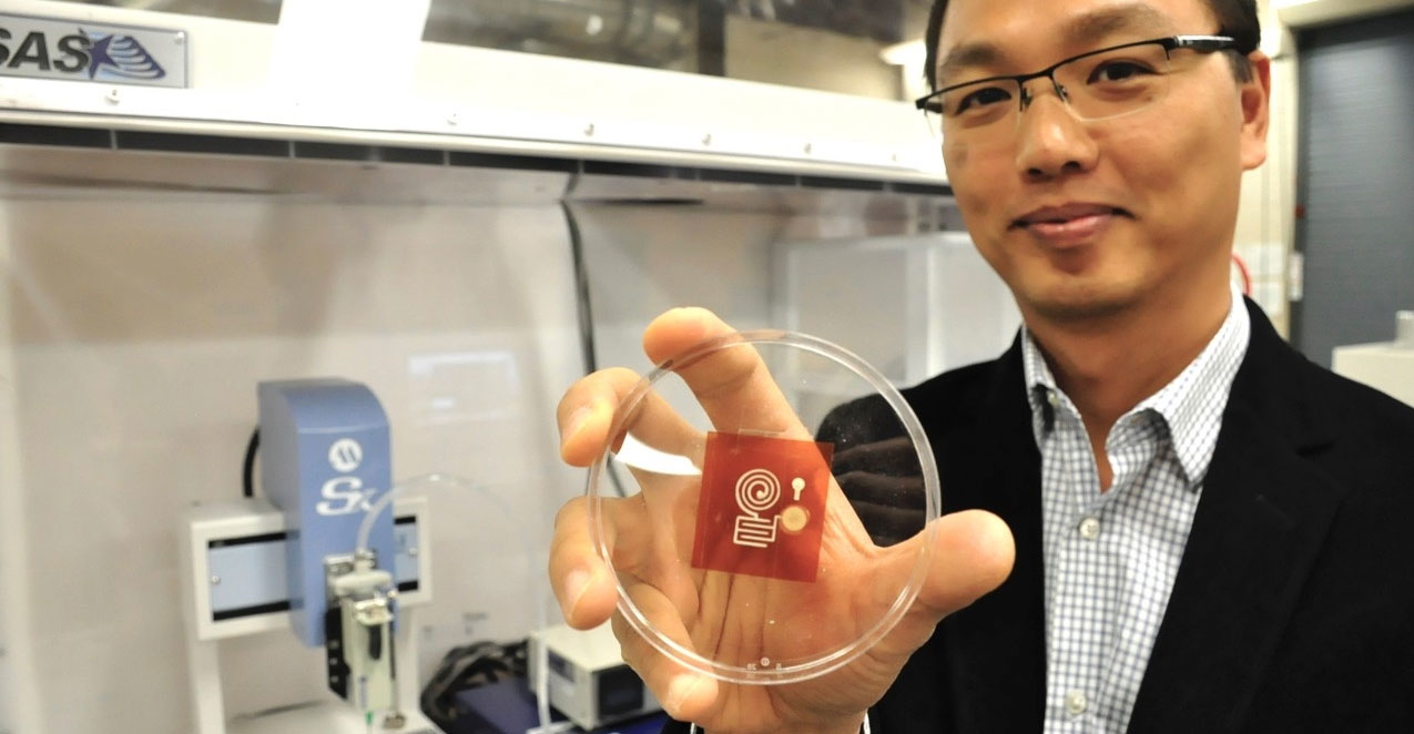

1. Simon Fraser University Mechatronic Systems Engineering professor Woo Soo Kim holds one of the sensors developed by the multi-institute team (Source: Simon Fraser University)
The goal is to replace the plastic of common printed circuit boards (PCBs) with eco-friendly and disposable chemical sensors. “If we are able to change the plastics in PCB to cellulose composite materials,” noted project leader Professor Woo Soo Kim (SFU professor at FSU’s School of Mechatronic Systems Engineering), then “recycling of metal components on the board could be collected in a much easier way.”
To achieve this, they used a printable conductive ink that’s designed and optimized for cellulose nanofibers (CNFs) by adding silver nanowires (AgNWs). For better resolution of the printing, they used a polyimide film that has high surface hydrophobicity as a substrate. They were able to create 3D-printed sensor circuits that included inductor–capacitor (LC) circuits along with ion-selective membrane electrodes (Figs. 2 and 3). These electrodes can be tailored to selectively detect quantitative ion concentrations.
