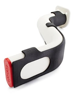

For example, Rutland Plastics appreciates PolyJet multi-material printing for use as a holding fixture (Fig. 6).
6. Rutland Plastics uses PolyJet as a low-impact manufacturing aid because it prints in flexible, soft-touch materials that are ideal for delicate, glossy surfaces.
Rutland Plastics uses PolyJet to print in rigid white material with flexible black over-molded surfaces and inner features. The flexible black material showcases built-in work instructions. The rigid material aids in durability while the flexible material provides a soft touch surface for Rutland’s products that have glossy, cosmetic surfaces.
Rutland estimates that PolyJet aids have saved them roughly $600 when compared to a CNC machined holding fixture. While PolyJet is not a durable option for long-term manufacturing aids, it can be an ideal solution for short-use fixtures because it can print a new part within hours and provides elastomeric options.
