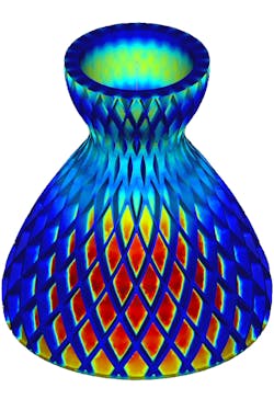

With implicit modeling, we’re not just limited to simple distance fields to drive geometry. Any field can be used to intelligently drive the ribbing configuration. Examples of usable fields include stress, thermal, and fluid simulation data. You can practically drive geometry with any data you have. In the rocket nozzle example, we’re going to use Von Mises stress data to influence the thickness of the ribs (Fig. 3) . Where higher stress values exist, the ribs are made thicker to provide strength where it is needed. This design workflow is enabled by systems built on implicit modeling, as fields are the foundational language in which component data is represented here.

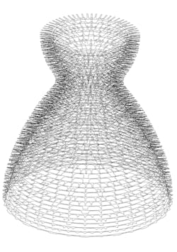

The final step in creating additive-manufacturing-ready models is to create contour slices that can be read by a 3D printer (Fig. 4) . A distance-field-based platform provides the freedom to generate and specify additive tool paths and scan patterns to deliver directly to machines without the use of intermediate STL files.  STL files are triangular boundary meshes of a component’s geometry and are problematic, as they can introduce integrity issues and become impractically large as model complexity increases. Eliminating them from the process by delivering print-ready slice data greatly improves process efficiency.
